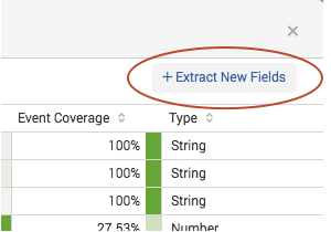

  1. Run a search that returns events.
  2. Scroll down to the bottom of the fields sidebar and click Extract New Fields.
    The field extractor starts you at the Select Sample step.
