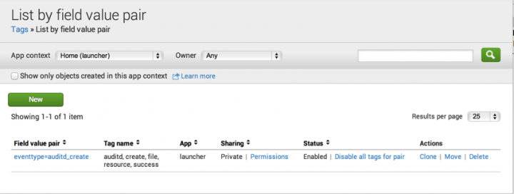

Managing tag sets associated with specific field-value pairs
From the List by field-value pair page, you can review and edit the tag sets that have been associated with particular field-value pairs.
Use this page to manage the permissions for a field-value combination with tags.
To see the list of tags for a field-value pair, locate the pairing and click on the field-value pair. This opens the associated detail page for that pair.
The following is an example of a set of tags that are defined for the eventtype=auditd_create field-value pair.
You can add and delete tags from this view, if you have the permissions to do so.
Click New on the List by field-value pair page, to define a set of tags for a field-value pair.
When you create or update a tag list for a field-value pairing, you might create tags, or associate tags with a different kind of field-value pair than they were designed to work with. As a knowledge manager consider using a carefully designed and maintained set of tags. This practice aids with data normalization, and can reduce confusion on the part of your users.
See Manage knowledge objects through Settings pages.
You can verify the existence of a field-value pair that you add to the Tags by field-value pair(s) page. The system does not prevent you from defining a list of tags for a nonexistent field-value pair.
