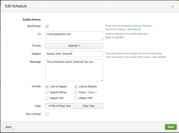

Define a Send Email action
This procedure shows you how to use the Edit Schedule dialog to set up a Send Email action for your scheduled report.
You cannot set up this kind of action without first configuring email notification for your Splunk deployment in Settings. See Email notification action in the Alerting Manual.
1. Enter the Edit Schedule dialog, define the report schedule if necessary, and click Next.
See "Schedule a report," in this topic.
2. Select Send Email to create an email action.
The Edit Email Options dialog opens.
3. Provide a comma-separated list of To email recipients.
4. (Optional) Provide a comma-separated list of CC, and BCC email recipients.
Click Show CC and BCC to see the CC and BCC fields.
5. Set the email Priority.
Enforcement of priority depends on your email client.
6. (Optional) Provide the email Subject and Message.
You can use tokens in email subject and message text to provide a wide variety of information to your users. See Use tokens in scheduled report email subjects and bodies in this topic.
7. (Optional) For Include, select options to include or attach information about the search and its results.
In the email, you can include:
  • A link to the related report.
  • A link to the results of the run of the report that the email represents.
  • The search string for the scheduled report.
  • The results of the report run, in the form of an inline table, CSV file, or raw event list.
You can also attach the results of the report run in the form of a CSV file or a PDF. See Include results in scheduled report emails in this topic.
8. (Optional) Change the email Type to Plain Text.
Type is set to HTML & Plain Text by default.
9. Click Save to save your email action settings.

Schedule a report in Settings
You can schedule reports through the Searches, Reports, and Alerts page in Settings.
Scheduled reports cannot include time range pickers. When you schedule a report that includes a time range picker, Splunk software removes the picker from the report.
Scheduled reports can only run as owner. When you schedule a report that has been shared to run as user, Splunk software updates that setting so it runs as owner. See Determine whether to run reports as the report owner or report user.
Prerequisites
Review the following topics.
Steps
  1. Open Settings and select the Searches, reports, and alerts link.
  2. Click the name of a report that you want to schedule.
  3. On the report detail page, select Schedule this search to open up the scheduling and alerting options for the report.
  4. Select a Schedule type.
    Option Description
    Basic Lets you select a preset schedule period from a list, such as Run every 5 minutes or Run every day at midnight.
    Cron Lets you define a custom schedule period using standard cron notation.
  5. (Optional) Select a Schedule Window for the report to run within.
    When there are many scheduled reports set to run concurrently, you can set Schedule Window to specify how long the report scheduler can defer this report and cause it to yield to higher-priority reports. Only roles with the edit_search_schedule_window capability can see Schedule Window or set it to a value other than No Window.
  6. (Optional) Select a Schedule Priority for the report.
    Use Schedule Priority to raise the scheduling priority of this search. Use with discretion. Only roles with the edit_search_schedule_priority capability can see Schedule Priority or set it to a value other than Default.
  7. To make the report behave like a report that has been scheduled with the Edit Schedule dialog, set the alert Condition to Always.
    This ensures that the alert actions you define are performed each time Splunk Enterprise runs the report.
  8. Set Alert mode to Once per search.
    Do not activate Throttling for scheduled reports. Do not set Expiration and Severity for scheduled reports.
  9. (Optional) Define the alert actions required for your scheduled report. Do not define alert actions for a scheduled report that runs in real-time.
  10. (Optional) Select Summary Indexing if you want the scheduled search to populate data into a summary index.
    See the documentation of the summary indexing functionality to learn more about these settings. You do not need to set up summary indexing for searches that already benefit from report acceleration.
  11. Click Save to save your changes.
