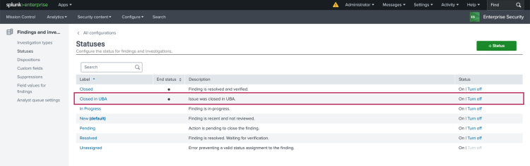

Work with Splunk UBA threats as notable events in Splunk ES
When Splunk UBA and Splunk ES are integrated using an output connector, Splunk UBA creates a new custom status on Splunk ES called Closed in Uba as shown in the following image.
This screen image shows the Status Configuration page in Splunk ES with a list of available statuses for notable events. The status with the label Closed in Uba is highlighted.
The status of threats in Splunk UBA and their corresponding notable events in Splunk ES are synchronized.
