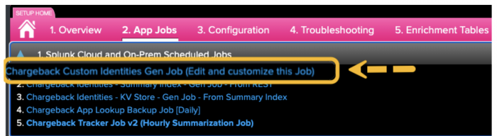

  3. Open the Chargeback Custom Identities Gen Job (Edit and customize this Job) and configure this job to collect the information below about users in your organization that are using Splunk today or separated from the organization leaving behind scheduled jobs. It is best to have a reliable repository preferably being indexed daily or weekly that has this information in it.
  4. This screenshot shows Chargeback Custom Identities Gen Job.
