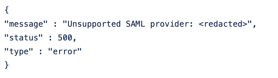

You see an error message that your SAML provider is unsupported π
Symptom π
Cause π
For IdP specific integrations such as, PingOne, Okta, or OneLogin, Splunk Observability Cloud expects that the requests come from particular domains or URLs.
Solution π
Use the generic SAML integration instead of the integration dedicated to your IdP. Most IdPs have built-in generic SAML 2.0 plugins that are used for this purpose. Enabling generic SAML requires additional actions. See Configure SSO using a generic SAML SSO integration.
