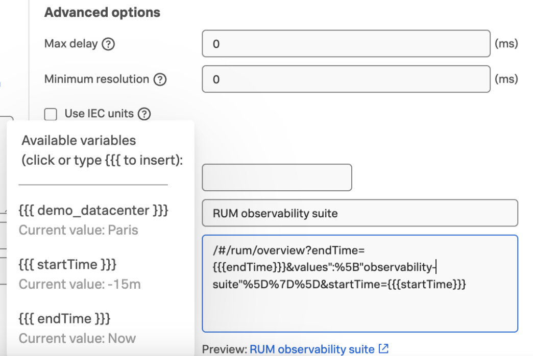

Max delay ๐
By default, the Max delay field is set to Auto
, which allows data to come in with as little delay as possible.
If you know that some of your data is delayed and you want to wait for that data to arrive before your charts are updated, click the drop-down menu and choose a new value from the list. For more information, see Delayed data points.
The value you specify is applied whenever you open the chart or view it in a dashboard, unless there is a max delay override. To learn more, see Max delay value.

Minimum resolution ๐
This option specifies the minimum interval for which Splunk Observability Cloud should roll up values to display a data point on the chart. For example, if you track the number of support calls received per hour, you might not want to see a chart that shows data points representing the number of calls received every 15 minutes, even if data is available at that resolution. Setting this option to 1h ensures that the data points represent values for periods of 1h or more.
To learn more about rollups, see Rollups.

Use IEC units ๐
This option lets you specify whether Y-axis values are shown in decimal units (1k = 1000) or IEC units (1k = 1024).
