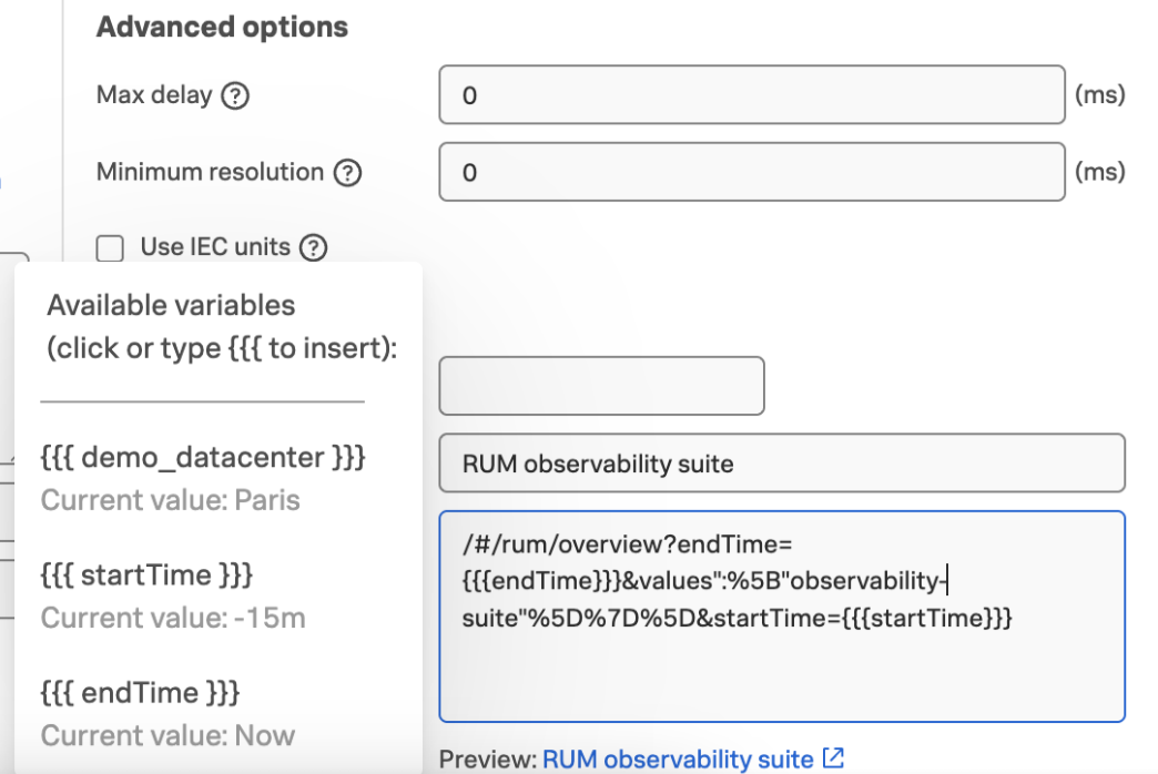

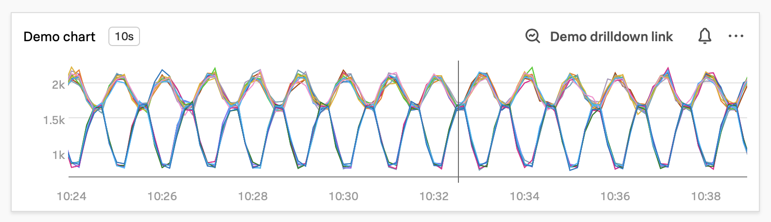

Drilldown link 🔗
This option lets you add a drilldown link to the chart header when you view the chart in a dashboard.
Providing a drilldown link helps other users in your organization navigate to other parts of Splunk Observability Cloud or external resources containing data related to the chart.
You can include dashboard variables and time range in the URL using curly brackets, such as startTime={{{-15m}}}
. For more information on dashboard variables, see ダッシュボードの変数をカスタマイズする.
For example, you can configure a link to go from a chart to a RUM instance during a specific time window for the same metric.
